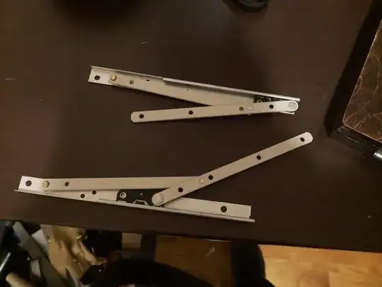

Well I found them. This egress casement hinge fit the bill perfectly. After poking around for long enough I discovered an "egress" casement window hinge (egress means for windows that can be used as exits in emergencies). While the hinge in the picture on the website is open to a bare 90º, I bit the bullet anyways because the track gave it more space to turn. After receiving them, I can personally attest that they open far more than 90º, probably closer to 150º. It would appear that they just used a track for a non-egress window (one that needs more space to open) leaving the egress hinge with plenty of extra space to turn. And they didn't put a stop in it too!.
