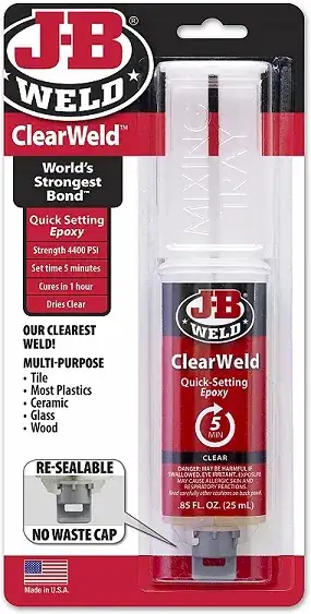

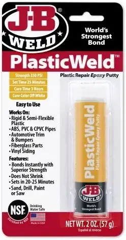

Look into epoxy glue mixes such as:
or
You can read the package or call the company to check if it will work on your specific plastic.
