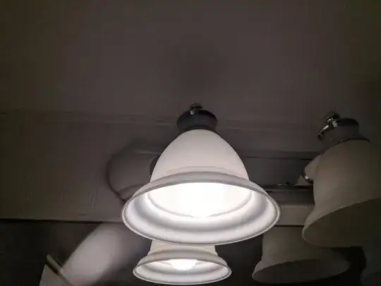

I just replaced my bathroom light fixture bulbs with newly bought bulbs (LED, A19, 40W equivalents). What I get is a head-scratcher: the bulbs light up dimly as soon as I screw them on and the switch is off. If I push the switch on, the bulbs function normally, but with a noticeable buzzing sound. Looks like this:

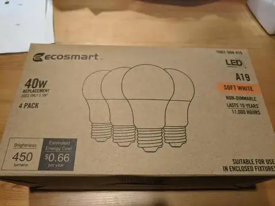

I am trying to figure out if there is something wrong with the new bulbs or the circuit. This is the box that the new bulbs came in.

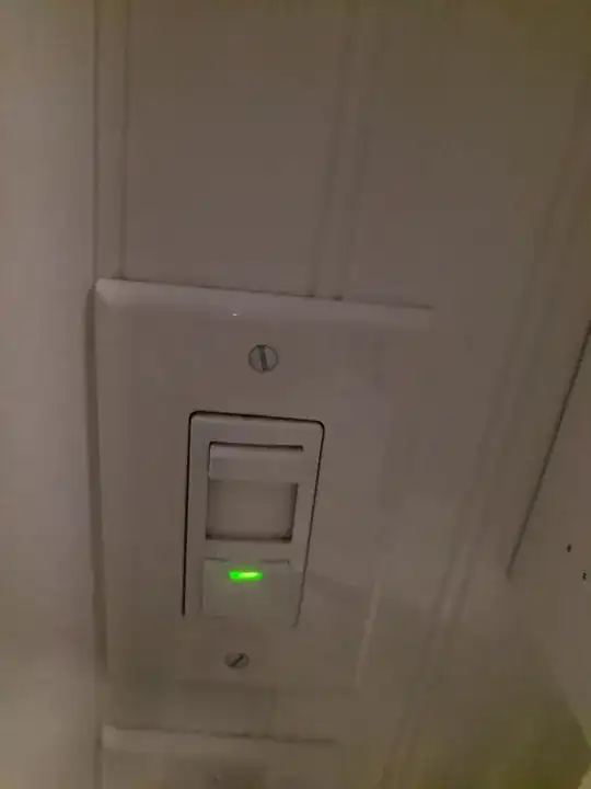

My previous bulbs are of the same brand and the same kind (LED) but a higher wattage. My money is on that this has something to do with the switch. Most of my switches have a dimmer and a little LED that helps locate the switch in the dark. Does this mean I will have to go back to my old bulbs? Do I need to worry about the circuit?

  • The box says NON-DIMMABLE.
  • You have a dimmer.
LEDs are different from incandescents.
With incandescent bulbs, you can leak a little current through a light and it doesn't matter. You can vary the current and it works fine.
With LED bulbs, a little current goes a long way. So a very tiny bit of current leaked through by a dimmer "nearly off" or for indicator lights/electronics to work when "off" is enough to cause a glow or blinking lights. A larger current in "dim" mode can cause blinking, buzzing or other problems.
Why is there a buzzing sound when the bulbs work?
Many dimmers work by, essentially, turning the power on/off very quickly. With an incandescent bulb that works great - "all the power 1/2 the time" is basically the same as "1/2 the power all the time" - i.e., 1/2 as much light. With an LED bulb, special circuitry is needed to figure out that "all the power 1/2 the time" means "1/2 the light" and not "turn the light on/off every time the power goes on/off. Depending on the circuitry, a non-dimmable LED bulb can react by:
  • Turning on/off a lot == blinking
  • Not working at all
  • Buzzing as various components that were not designed to turn on/off very quickly end up turning some of that energy into vibrations.
Return the bulbs and get ones that are marked DIMMABLE.

The first problem is probably the dimmer, you need a smart dimmer (they usually require a neutral) some lighted switches use neon lights in the switch, even these draw enough to light many types of LED lamps. There are some dimmers that are LED compatible that do not require a neutral. You need to find an LED compatible switch and everything will work the way it should.
