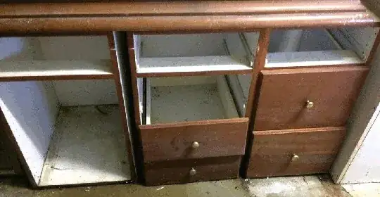

I was trying to describe a specific part of a set of drawers in another question, and cannot find the right name for it.
A photo showing the same part. Notice not all drawers have these, or they may be spaced out in a reduced number - I have one set where there's a drawer-thingy every two drawers, not between each.
Given that every part of any item made of wood has some kind of name, I'm positive this does but can't find it.

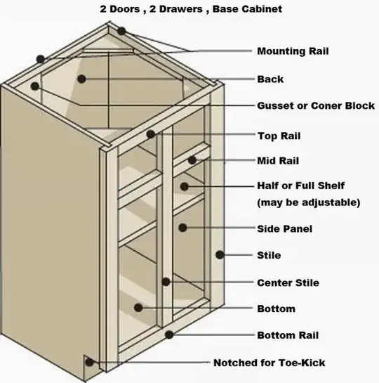

According to this diagram¹ it is a 'mid rail'.
That's a pretty standard North American term. It's quite likely you would find alternates from the UK, Europe, etc. I once worked alongside an architect who was educated in England. This fellow tended to call any horizontal support a lintel although I believe the true definition is a bit stricter.
¹ This diagram seems have at least one typo. 'Gusset or Coner Block' should most likely be 'Gusset or Corner Block'.
That looks sort of like a web frame, although only the front rail. A web frame supports the drawer, provides a place to mount the drawer runners, can frame a dust cover, and stiffens the cabinet. From the picture, this looks like it's only there for the last function.

I work at a cabinet shop. The top picture is a face frame cabinet, the name in your diagram is an accurate reflection of what we call it at our shop in the US. The second picture you have is a euro construction cabinet.
We build both and for the euro cabinet we just refer to it as a "drawer stretcher" it's only purpose from what I can tell is to add more strength to the cabinet and keep it more square. Just like stretcher boards would on a face frame cabinet.
