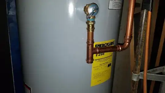

Note that it talks about the pressure relief valve (technically temperature & pressure relief valve), not an expansion tank. The pressure relief valve is usually mounted on the side of the water heater and looks similar to this (on a new water heater, the piping won't be there): pressure relief valve
To test this valve, remove the piping if you can't see where it terminates (you'll need to see if water is coming out the end). If you can see the end, you can leave the pipe on. Carefully lift the lever on the valve up. Do not lift it all the way as that will lock it in the open position. If you get water coming out, you're good. If not, or the valve is stuck, you'll need to replace the valve.
