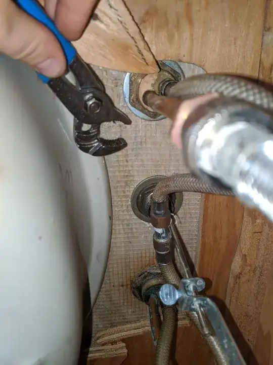

My bathroom faucet is dripping, and I would like to change the washers in it. The problem I am running into is the placement of the nuts holding the faucet valves in place:
underside of sink
This is the underside of the sink, the hot and cold valves are on either side. The nuts holding the valves in are quite large, and they are inside a small recessed space that I can barely fit a small pliers into, much less one large enough to actually get around those nuts. Does anyone have any suggestions for how I might get those nuts off?

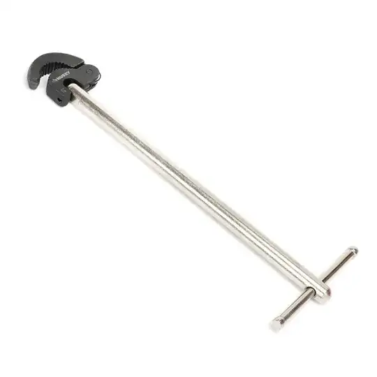

This is exactly the purpose of a basin wrench
basin wrench

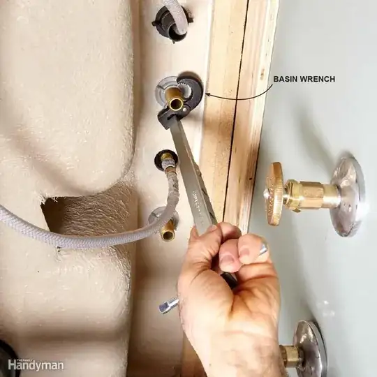

Here's a picture from familyhandyman.com that shows a basin wrench in action:
basin wrench
Note that as mentioned in another answer, you usually don't need to remove the faucet to replace the washers; but if you do need to remove the faucet for whatever reason - this is the tool.

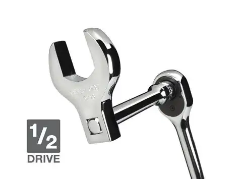

A crowfoot wrench might do it, if you can find one that's the right size to fit those nuts.
Another option (much more work) is to disconnect the pipes lower down (where they join the hard lines), disconnect the drain, and pull up the whole sink.
