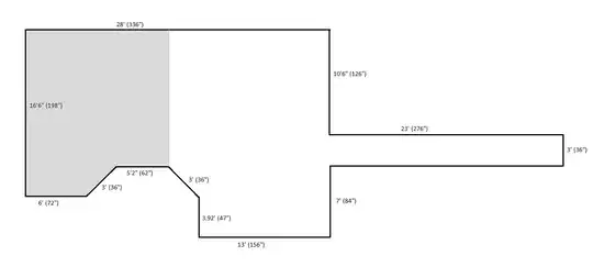

Here's my overall plan: enter image description here

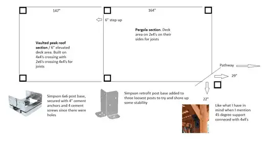

And, the issue at hand:
Primary issue: Wife didn’t want 6x6 pergola post in what is essentially the entrance to the side walkway that will be decked. Due to this I caved and moved the post off center by 24” south and 29” inches east respectively (see image link above, bottom right corner).

So getting back to my main concern, about that wonky post that is 24” south, and 29” east of the rectangle (measured from outside of post to outside of post). My idea for a solution since it’s on the pergola side would be to put a 45 degree 4x4 going from south to north, to then meet the 2x6 (or 8) beam coming from the northeast post. Then another 45 degree 4x4 going from east to west to secure the higher cross beam. Cross beams will either be 2x6, or if height allows 2x8 for extra support. They will then meet each other where the post should have been, and I will use a Simpson connector to secure them to each other (probably 2 or 3 – the ones that look like a cross basically).

Edit 1: Images of the deck from straight on angles to show out of line post, and quick terrible image in paint to show where I'd put what I've decided are 6x6 45 degree braces so I can sandwich the 2x6 heading north/south, and the 2x8 heading east west (2x8 on the slightly longer span). For reference, the decking is east/west. https://i.sstatic.net/QaVfa.jpg

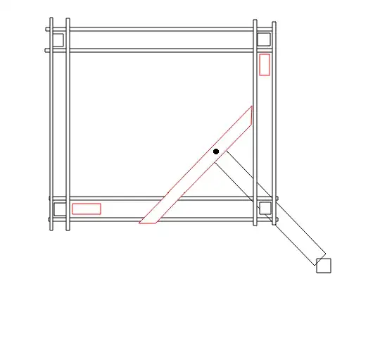

What you're trying to do appears possible, with a few extra parts. See here (forgive the crappy art, I made several edits):
lousy drawing of beams and posts
The two red rectangles are the beam-post braces I would add (minimally) to handle the horizontal loads which can no longer be handled by your odd post.
The post I drew where there isn't one is just a short floating section used to fix the two beams together.
What you need to build so your post does not need to be buried in concrete is a cantilever. Extend the 45 degree horizontal beam some distance inside the pergola. The longer you make it, the less load you will have where you join it thanks to leverage. I would aim for as much inside as there is outside. Fix the end to another 45 degree beam (shown in red). This needs to be rather strong as it will be handling roughly the weight of that corner of the pergola. Except that end will be trying to move down, not up. Think of that joint as hanging a large weight on the red beam.
I've shown the red beam as resting on the 2x6 beam, but attached to the side of the 2x8 beam. It should be easy to find some kind of metal L you an screw to the 2x8 and rest the beam onto.
The connection between the two 45 degree beams could be a large bolt down the center, with appropriately large washer. They will be about 6 inches apart vertically as the red one is over the 2x6 and black one under, so that would likely be easiest. But it's also possible to insert a short section of wood and use steel plates to fix both ends to the beams properly.
I also suggest resting the 45 degree beam on top of the post, with some minimal fixing to keep it from moving around. I would drill a hole from the top and drop a rod which will not rust in it. Same deal where the 45 degree beam meets the tiny floating post. A lag bolt from below would do fine. Or any kind of screw you can get that's long enough, it won't be pulling anything but its own weight.
With that setup, your odd post does not even need a brace to the horizontal beam to hold everything up. But it will help overall stiffness to have one.
