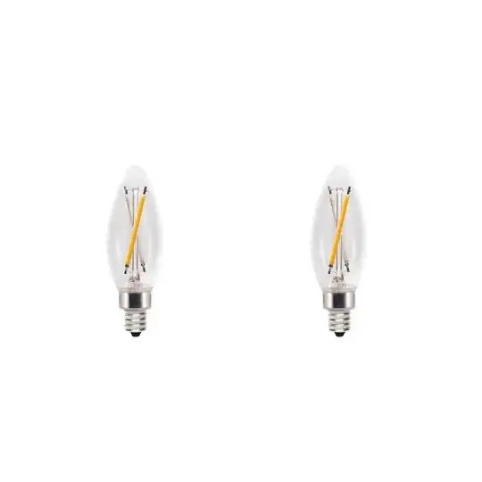

then searching Home Depot as an example, I found a Cree "25W equivalent", 220 lumens, actual usage 2.6 W. enter image description here
So that will provide comparable light to a 25W incandescent bulb.
