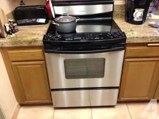

This is a a similar model (to show you where the control panel is:

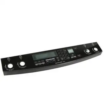

This is a the control panel:

I finally figured this out. The rear is kind of held on with a loose "clip". First, clean out all the gunk that accumulates in the crack between the display/touch panel and the glass top (I used a thin putty knife). I think that "glues the back on" which was part of my problem. Then, (after you remove the three screws), just lift the front display up like the back is hinged. You may need to pull forward just a bit after you pull it up an inch or so. As the front lifts up, the back eventually pulls away. (There's very little force holding the back).
