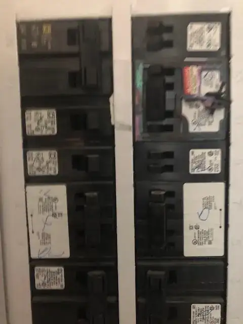

With both 240 and 120v devices having a problem I would first call the power company and report the problem to them. Usually they will preform a service safety inspection for free (they don’t want a fire in their gear). Then I would check the type of panel there 2 brands known to have these problems the first is federal pacific (FPE) the stablock model of breaker is known to fail (to the point I will only remove them). The other is zinsco , I haven’t seen the extent of problem on these but others have reported.
If neither of these brands one thing I will do is turn all the small breakers off, then cycle the main breaker on and off 10-20 times. This cycling the main breaker can clean carbon off the hammers in the breakers and reseat them For a temporary fix.
If you feel comfortable remove the dead face or front cover from the panel and look at the main feeds looking for overheating damage (I would expect your electrician at least did this).
Providing us with a photo of the panel and model number we may come up with additional possibilities if the utility comes up with nothing, but most of these failures I have seen have been on the utility side other than a few main breaker problems or rule of 6 “main” for the lower section.

A circuit is defined as a circuit breaker (often a double breaker with tied handles) and all the outlets and hardwired devices that it controls, i.e. that lose power if you switch it off.
Obviously, some circuits are failing, and whole circuits are failing at the same time (that is, all the outlets/devices on the circuit at once).
So I need you to identify the failing ones. Often if your panel is properly labeled as required by law, this won't be too hard.
Cut up some Post-It notes to make flags, and stick the flags on the breakers that are failing. Then, shoot us a photo of the panel face. Also if possible the label that describes the make/model/instructions of the panel, and the breaker labeling chart if any.
Do this before you call in an electrician. This may be free to fix.
What I want to see is if all the failing breakers fall into a pattern that looks
If it does follow this pattern, then this is almost certainly a power outage from the power company. This is what power outages look like. "Why doesn't the power fail completely? Because in North America, power is delivered as 3 wires. Typically 1 wire fails. 2/3 chance it knocks out half your panel. 1/3 chance it causes a floating neutral which makes your voltages go bananas.
