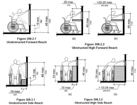

Now if there are any requirements for ADA accessibility, receptacles and switches must be between 15" and 48" and unobstructed.
ADA requirements
