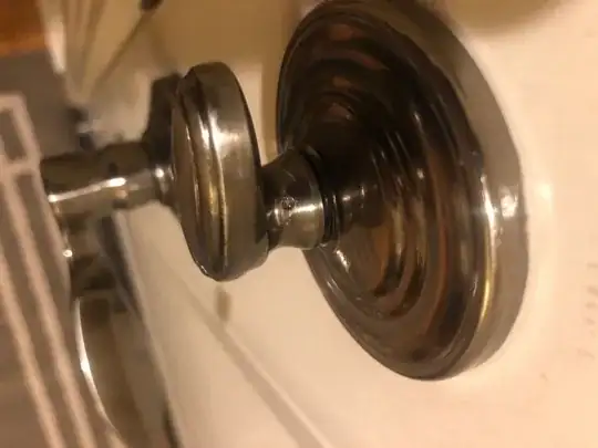

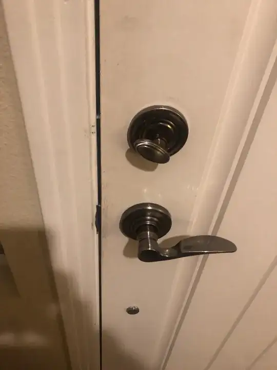

frontI'm unfortunately having a lot of trouble removing my thumbturn of my door. Please see pic. It's a Schlage that was on this house when we bought it as the model home in 2007ish.
I've tried pushing in the small hole with a small allen wrench while trying to pull the thumbturn out but that hasn't done anything. There are no visible screws. Thanksenter image description hereenter image description here

I have a similar lock. Press straight down in the center of the hole with an awl while wiggling the knob and pulling gently. There is a small spring loaded pin that has to be depressed to remove the knob
