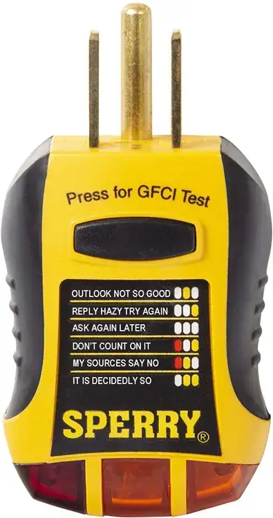

Speaking of testing, those 3-lamp testers have 3 Rather Useful lights which let you do three tests at once. (Obviously, if any lights light, the outlet is most likely hot; but that is not enough.) But the little chart/legend is completely wrong; it's about as useful as a "magic 8-ball". It's actually optimized for new construction; once built, houses have different kinds of problems.
  • However, the GFCI tester function is very nice; if you suspect a redundant GFCI, use the 3-lamp tester's TEST button. It will trip this GFCI (obviously). But if this one turns stone dead and refuses to reset, it tripped another GFCI somewhere else, which means this one is redundant and doesn't need to be a GFCI.
