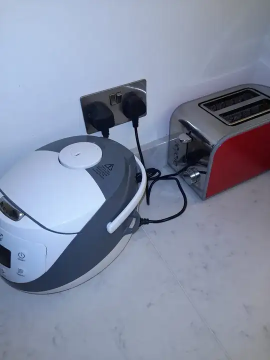

The superior BS 1363 Type G socket - Leviton's model BSRDP 240v socket. It's double pole switched which is of importance in the USA, since the 240v power system has two (180 degree opposed) 120 volt lines. Since there's no neutral in the 240 volt circuits, both sides are live at 120 volts potential at any given time.
Below, the Leviton BSRDP 240v BS 1363 Type G socket.
The Leviton BS 1363 Type G socket. Model BSRDP 240v
USA/Canada can simply change over to a superior socket and fused plug for the 240v outlets immediately. Then gradually replace the 120v outlets and appliances. Also move to 240v lighting to make the house all 240v. Saudi Arabia, a country of 27 million, is moving over away from the US system to the European 240v line and neutral using British type G plugs.
Below the BS 1363 Type G socket:
