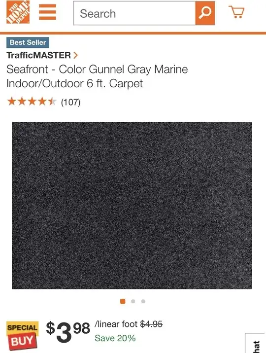

I use a scrap of unbound carpet like the marine carpet found at big box stores enter image description here

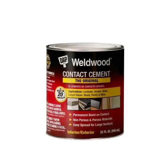

Cut a strip to size needed and use a contact type adhesive like enter image description here
Follow directions that say apply to both the rug scrap and the ladder with a cheap paint brush. Allow it to dry until it is not sticky to touch. Now align carefully and press the glued surfaces together. The bond is instant and not movable so get it positioned right before allowing contact.
