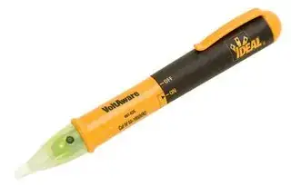

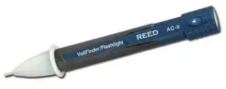

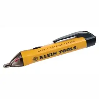

  • Head down to the local hardware store, and pick up a non-contact voltage tester (any brand will do).
non-contact voltage tester enter image description here enter image description here enter image description here
  • Carefully remove the cover plate from the switch, and move the tester near each wire (you won't have to touch the wires, just get near them). If you hear a beep and/or the light turns on, the circuit is hot.

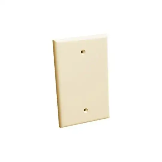

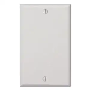

If the circuit is not hot, you still will not be able to cover the box completely. You'll either have to remove the box and all wires leading to it, or cover the box using a blank cover plate.
Blank cover plate
If you decide to use a blank plate, you can wallpaper the plate itself (while not attached to the wall). This will help it blend into the wall, and all but disappear.

Depending on where you are located, it may be a code violation to cover it over completely. The accepted solution in most areas is to buy a blank outlet cover, like this:
http://img.zaplighting.com/media/p/o/9de73e5f70d4.jpg
Turn off the breaker (and if you can't figure out which one, just turn off the main breaker/fuse and disconnect the entire house)
Disconnect the switch, and put wire nuts and electrical tape over the loose ends.
Wallpaper first, and then put up the blank. If you need to, you can wallpaper the face plate separately before putting it up.
