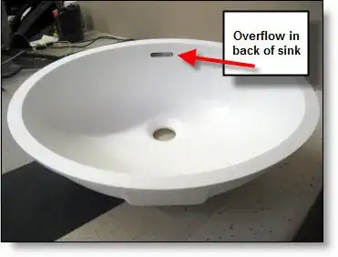

My wife dropped an earring down the overflow drain of her bathroom sink. The earring is about 1" in diameter, so the hole which goes from the overflow to the main drain is too small for it to pass through.
The earring is silver, so it's non-magnetic (I checked the other one to make sure).
Short of removing the sink and turning it upside-down, any other ideas on getting that thing out? I thought of just a hook and wire, but it would be a crapshoot on being able to hook it.
Just want to add, here's what the sink looks like. Note that the overflow drain is very narrow, and if you measured between the opening and the back of it, it's maybe 5/8":

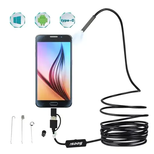

If you absolutely, positively, must know for certain that you've hooked the earring, the whole earring, and nothing but the earring, then you want an endoscope:
an endoscope
An inexpensive USB or WiFi endoscope with attachments costs somewhere around $10 US. All you need to do is connect the endoscope to a phone or a laptop and use it like a webcam. Using the hook attachment, snake the camera into the drain until you see the ring, then hook the ring and pull it out. It could also be used in conjunction with other hooks, grabbers, or even a vacuum.

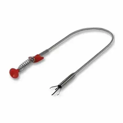

You could try a flexible claw pickup. Press the end, the claws open, let go and they close:
Steve Wellens
  • 7,127
