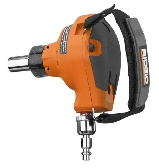

I think what you need is a Palm Nailer. You can get these in air or electric powered versions. They are compact and are handy to drive nails in tight spaces.
Palm Nailer

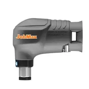

I saw one of these on demo at Home Depot for $49 CDN:
It's basically a vibrator that slowly drives the nail into the wood. I tried it on a big galvanized spike, and it went in effortlessly. However, you'll be faster using a decent claw hammer and a full swing. This seems to fit the bill perfectly for working in places where you can't get the backswing.
If that's too pricy, I've also had some success in this scenario with one of these (Pricing unavailable.) It at least allows me to start the nail.

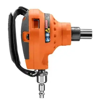

That problem used to plague me as well until I invested in a palm nailer: enter image description here
There are also electric, cordless versions if you don't have an air compressor.

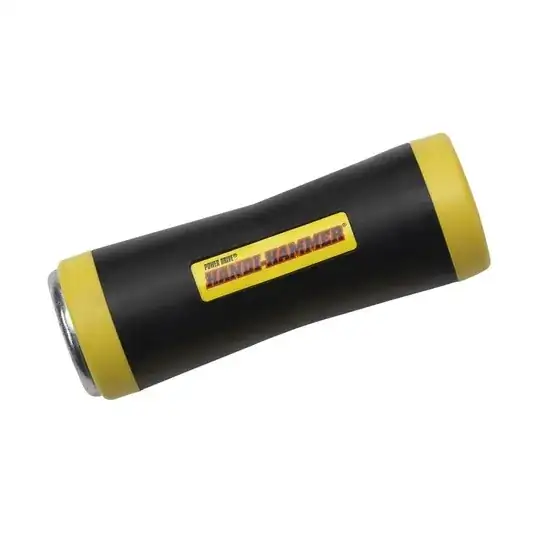

Palm nailers are the clear winner here, but I don't think the more low tech options have been fully explored? Handle-less hammers are available with brand names such as "Handi-hammer" and "Thumper".
