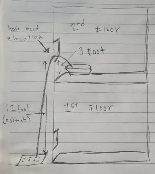

sketch of situation

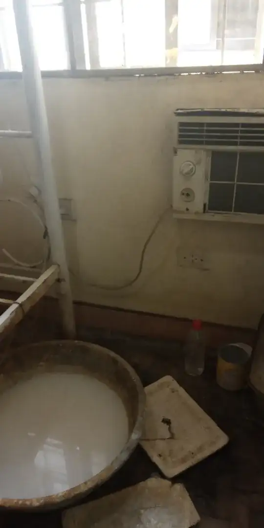

How can I pump this unclean water from our 2nd floor to 1st floor down to our drainage?
I keep accumulating a lot of water (enough to fill a water basin) every 2 days from washing stuff.
I'm thinking of using some kind of Hose to transfer it. I've heard of 'Siphon' method, but to do that, I have to go to 1st floor and suck the hose a bit, which I don't want to. The water is unclean.
I don't even know if 'siphon' will work in a 15 foot hose.
Or maybe use water pump. But I'm not sure what pump will I need. Are there any cheap water pumps out there that cost only around $10? water pumps that I see are a bit expensive.

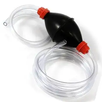

You can find a manual siphon pump at any large hardware or automotive store. It will look like a hand-sized rubber bulb, or possibly like a small hand-operated bike pump, with a hose on each end.
An arrow or other marker will be present on the bulb to show you which side is the intake and which side is the outlet. You simply submerge the end of the intake hose, put the end of the outlet hose at some lower point (in your case, out the window), and repeatedly squeeze the pump until it has pulled water up to and through the pump and water is flowing freely. Once the flow is established it will siphon out all the water (until the water height is equalized, which won't happen in your situation).

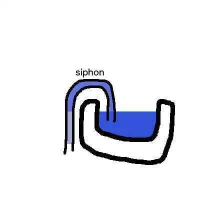

Wanted to add a clarification to the auto-siphon technique - you do not need to fill up the entire hose. You only need to fill up enough to make it without air gaps to a level below your siphon source, e.g. the medium-blue in my poor drawing below. If you have a 20 foot hose this means you can just coil up the first 4-5 feet in the dirty water so it is totally filled, plug that end (perhaps with your thumb or a bend to prevent fast leaks, and then toss as much as possible out.

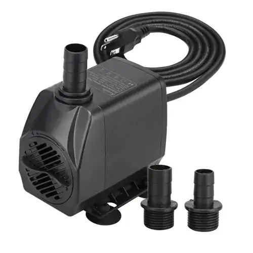

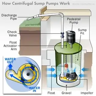

A small submersible sump pump should be sufficient to get a syphon action moving and can be made automatic with a float On/Off switch.
     Basic operation of a Sump Pump
The end of the discharge pipe can be higher than the 'unclean water' depending on the efficiency of the pump but it can always be lower providing that the pump is sufficient to raise the discard water 'over the top' of the highest point of the water's path. Once that occurs, water always flows downhill.
I would recommend using a siphon as it is uses no electricity. You can use a siphon pump or use some other techniques, for example you can pre-fill the hose before submerging it.
Otherwise use an "aquarium pump", they are much cheaper and will be adequate for the amount of water you are dealing with. Try getting the highest wattage within your budget, I reckon that 15-20w should be good enough.
