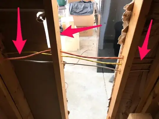

I'm adding a doorway under a stairwell and ran into wiring running through the wall. My question is specific to the wiring. I'm planning to add a junction box on each side, splice, and then extend the circuit up over the door frame. Maybe add one outlet.
The orange cable goes to the washer/dryer, and the white runs into the house for outlets in the laundry room while the yellow runs to the main room in the house.
My questions are around splicing and where I might add the single outlet. I need to splice all three and remove the 2x4 in the middle. Can I just use push in connectors on the orange, yellow and white cable to add a few feet? Can I also add an outlet to the yellow or white cable the same way (which I assume are both 120v)?
wiring within wall
A large enough junction box
