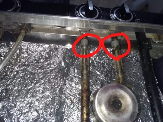

This is picture of my gas stove. There are two gas lines you can see, each controlled by knob and going to burner. Where I circled, there is a small slit , I am wondering what is that for ? Why wouldn't gas leak from there and catch flame ?enter image description here

The gas is mixed with air before going to the burner, the slit allows air to enter.
The gas does not leak from there becase there is a jet of gas causing a wind current blowing down the tube to the burner.
