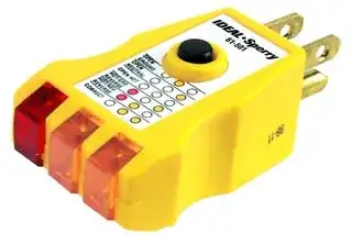

Determining if the GFCI tripping is causing the AFCI to trip, is a simple test. Simply press the test button on the GFCI. If the AFCI trips, you'll have figured out half the problem. If the ACFI does not trip, you could repeat the test using a receptacle tester with a GFCI test function.
If it's determined that the GFCI is causing the AFCI breaker to trip, replacing the GFCI receptacle may resolve that part of the issue.
