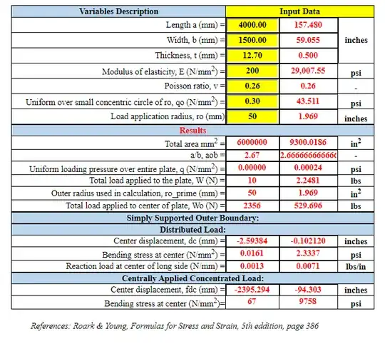

There are online plate deflection calculators. Here is 4 meters x 1.5 meters. 1.5 meters unsupported is a very long distance for a plate. I made some assumptions on the weight and allowable deflection. For 0.1 inch deflection (center displacement), and 500 lbs load (about 2 large people), you need 1/2 steel. This will be prohibitively heavy. JPhi1618's intuition is good, you probably don't want to use a plain plate.
https://www.engineersedge.com/calculators/flat-plate-deflection.htm
