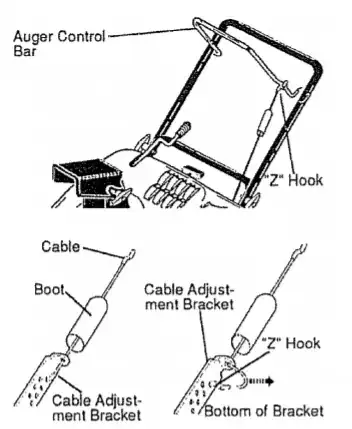

The auger control cable is my bet, make sure it's doing it's job, they do tend to slacken with vibration. If you can make the auger turn by pulling the cable with a pliers (carefully) it's not tensioned properly.
Craftsman-536.884581-augerControlAdjustment
