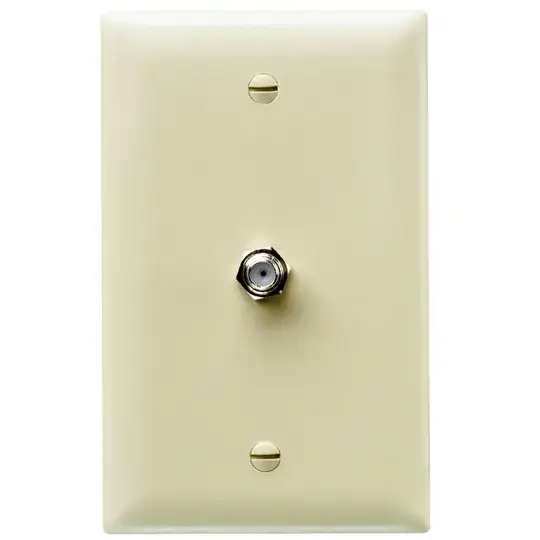

You could use something like this: enter image description here
Cut a hole in the sheetrock according to the template, and when you tighten the screws, the tabs tighten against the back of the sheetrock to hold in place. You then pull the cable through and use a plate like this:
Screw-On Coax Cable Connector

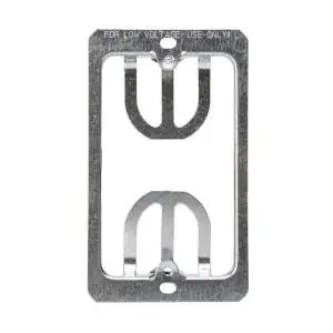

They make low voltage wall plate brackets that work well for this purpose. They should be in your local home improvement store with the various connectors for cable, telephone, and network wiring. I've used this one from Leviton. You cut back the drywall to the inner border of the bracket and fold back the tabs into the wall to hold it in the opening. As Edwin says, give the tabs a gentle crimp to make it tight to the drywall:
wall plate bracket
