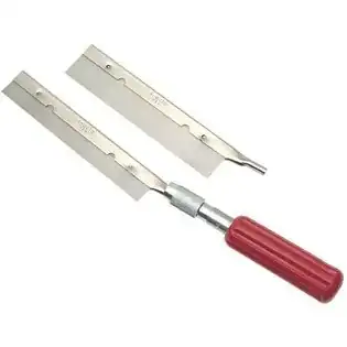

I would recommend cutting the peg(s) using a fine toothed saw like this one: enter image description here
These saws cut very smooth and are made by Xacto. Should be available from most serious hardware stores and craft centers.
