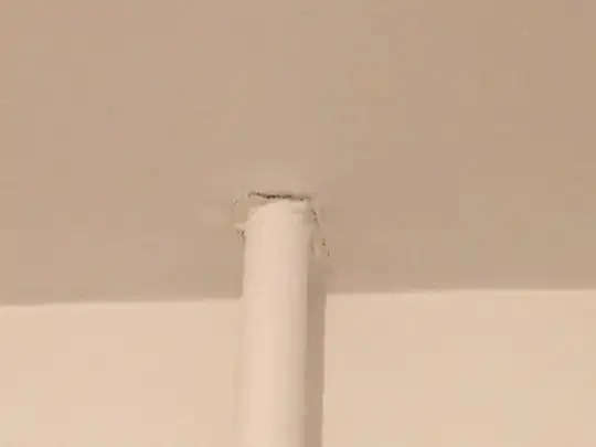

We're looking for a solution to cover or fix a crack that keeps reappearing around a a steam pipe we have. No matter how well we patch it and paint over it, it keeps coming back. Can anyone recommend a modern cover or a way to solve this issue. I have included a close-up photo below showing the crack around pipe.

Your crack is forming over and over because the steam pipe is getting hot, expanding, and cracking your plaster.
The solution is to cut the plaster back about 1/4" from the walls of the pipe all the way around, then to cover the seam with an escutcheon that hides the crack.

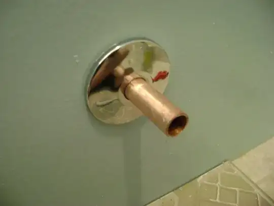

Example of a smaller escutcheon: enter image description here
