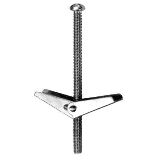

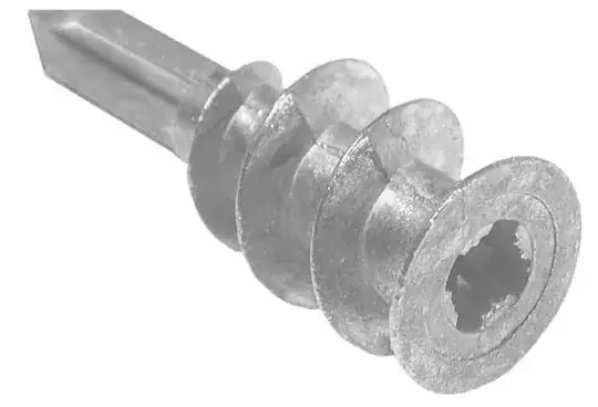

There are many different kinds of bolts and screws you can use on hollow walls to be able to take weight. Typically, you drill a hole first, then insert a special fitting into that hole, then attach your workpiece (shelf bracket, etc), then the bolt goes through the bracket and into the fitting. An older style of these are toggle bolts, which require assembly before putting the fitting into the wall, which look like this: Toggle bolt
but nowadays there are many different kinds, like this:
