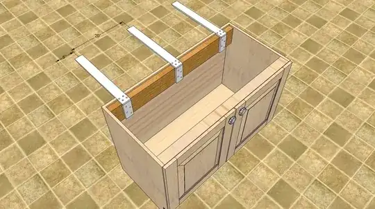

I have gone through this on about 20 installs and have gotten better from my first ones. The thicker the L-bracket the better. A lot of time the big box doesn't sell ones that are made for countertop jobs. This is something I usually order online because I get these cheaper and better quality.
I am going to give you pointers based on you making these as invisible as possible without the granite company scribing for them. For the granite installer to do this you would have needed to be set up during their measurements. They could have a "wide" scribe but I wouldn't go this way.
Steps:
  1. Take current countertop off cabinet.
  2. Take drawers or anything else out and out of the way.
  3. On the top of your cabinets where the L bracket is coming out cut out a indentions so that your L bracket is level with the top of the cabinet.
  4. Even with the bottom of the cutouts you are going to install a 2x4 (or 6) across the back inside of the cabinet.
  5. Great to get screws on this but I have used liquid nails before. (prop it up while glue dries if you go this way)
  6. Test it out. Make sure that L bracket is level and lines up (you can do this before glue dries if glueing) - you are installing the L bracket inside the cabinet.
  7. Do not screw in L brackets!!!
  8. When countertop guys arrive set the L brackets in place and let them install counter on top of them. This will assure they are positioned to support the counter. You could be microns off and will need to support that with a shim on the 2x side.
  9. Use a rubber shim if needed (seen wood shims fall out), and screw it in.
  10. Your installers may want you to epoxy the counters to the L bracket... don't. This does nothing but make it harder to uninstall.
Note for your install you want it out about 10-12 inches - I will say 12 to be safe. 12 inches plus 1.5 inches for 2x plus .5 inch misc.... means you need a 14" L bracket. I suggest you hit the side of the L bracket with an angle grinder on the corners facing the seated people to curve them out.
Also you want these about 6 inches from edges - can get away with 8 inches - you are really right on the edge of needing three brackets and someone doing a conservative install would use three.

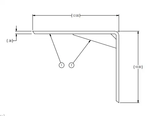

DMoore has a great answer. Let me add that you want a bracket designed for this purpose. 3/8" with gussets. 1/4" without a gusset is way too wimpy, unless it is as wide as your overhang. Mine is custom 1/4", made up of several pieces that span the entire width.
https://www.countertopbracket.com/
