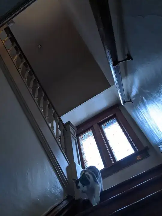

The second story ceiling is 8 feet 6 inches above the floor, as shown in this photo:
View of fixture from second floor

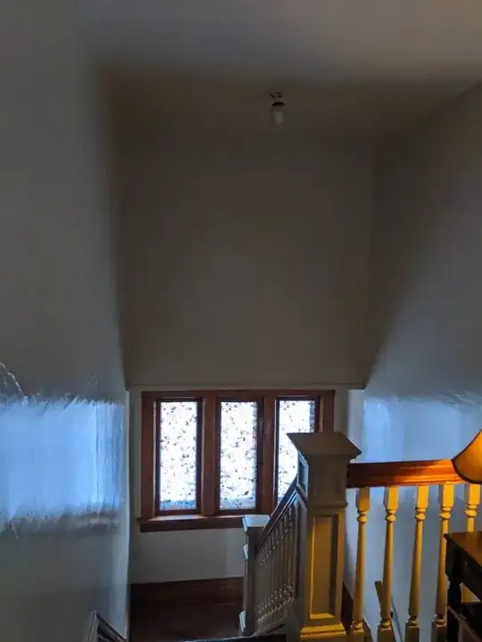

On the other side of the railing, the distance from the fixture to the closest step on the first flight is about 15 feet:
View of fixture from first floor (cat for scale)

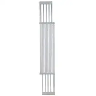

You can try this type of ladder. It allows for a configuration like this on a staircase:
ladder
Here is another option that might work as well.

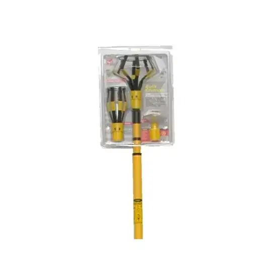

Most hardware stores sell bulb changing extension poles: example
I can't tell from the picture if there is a decorative shroud over the bulb; if there is I would change the light fixture.
