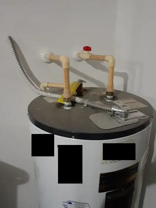

The water main pipes and valves are exterior to the home adjacent to the garage. After that, the only pipes on the outside of the walls are on the opposite side of the garage as seen in the picture below when entering/exiting the water heater.
Am I able to turn off the main, cut into the inlet seen in the picture, redirect that to a water softener next to the water heater, and then feed the outlet of the water softener back into the water heater? Or am I stuck having to cut through drywall at a closer point to the main?
I'm also not sure what to do about draining the water softener because there's nothing nearby that could take it. There's no floor drain or egress from the garage. The closest thing would probably be the laundry drain lines behind the drywall near the attached picture.

Yes, a DIY is feasible, provided you don't want whole-house soft water, just soft "hot water". The valve is for your cold water intake (a safety feature that should be on all water heaters), and you'll cut that line and rework it into your water conditioner, taking the outlet of your conditioner back into your water heater cold inlet. You'll keep a cold cut off valve (but probably not the same one), placing it between the wall and your water conditioner.
If you want your cold water to be soft too, you need an exterior softener between the house and the whole house cut off valve. I'd recommend avoiding DIY for an exterior job, as fixes are more complicated if things go wrong.
