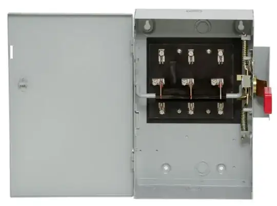

Get a 3-pole switch for the dryer.
The huge problem with electric dryers is that third wire is not ground. It is neutral. It is an active conductor that handles normal current for all the 120V loads in the dryer - basically every internal device except the heater. You must switch neutral. You have connected the two service panel's neutrals back to back, which means neutral from either panel has two choices of path -- back through the service entrance, or via the dryer connection to the other tenant's panel. This can cause all manner of problems, and is certainly the most likely way I can think of to set an apartment on fire.
(or you've connected neutral to only one service, but that has a whole 'nother way to set the house on fire).
Neutrals do not have circuit breakers. The safety of the neutral wire depends absolutely on the concept that it only returns current from its circuit. As soon as you criss-cross neutrals between circuits, you can overload that neutral. There is a variety of ways that could fail deadly. Including some that could electrify the chassis of the dryer, because of that obsolete, unsafe 3-prong connection!
Things get even more serious when criss-crossing neutrals on two services, because now the criss-crossing neutral wire could carry all the current for the entire service. That'll start a fire for sure.
It is all right to criss-cross safety ground wires; in fact if you use metal conduit for your wiring method, it's inevitable. I have a building with 4 separate services all sharing the same metal pipes on a metal building, and thus, same safety ground. But the important thing is that a 3-wire dryer connection has no ground; that wire is neutral.
Lastly, I very strongly urge you to convert to a 4-wire connection to the dryer, including removing the (technically legal) neutral-ground bootleg strap. Because this type of switching adds a risk of a problem with the neutral (gee, you think? :) and on a 3-wire connection, that causes the chassis of the dryer to become electrified!
