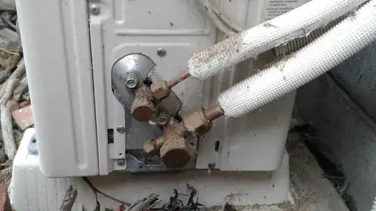

I need to temporarily move the outdoor unit to one side to access the wall behind it. Is it possible to do this with basic tools? I just need to disconnect the copper pipes as there's enough slack in the power supply so I can keep the wires connected.

You need an adjustable wrench and a set of hex wrenches.
  1. remove the valve caps. These are the two large brass caps facing you in the picture (NOT the small caps on the left). you will see a hex-head valve under each one.
  2. Close the valve on the small (upper) line.
  3. Turn the unit on, COLD cycle, and listen carefully to the outer unit. After a minute or two the motor sound will change slightly - this is when all the refrigerant has been pulled into the power unit and the air handler + pipes are empty (of anything - they will be near-vacuum).
  4. Close the valve on the lower (large) line.
  5. Turn the unit off and unplug it.
  6. Crack open the nut on the large line. You should hear gas hissing - that is air going IN to the system and it will stop soon. If anything comes OUT, close the nut immediately and repeat the above. For reference, the pipes carry semi-liquid refrigerant at about 100+ PSI. It will be very obvious if they are pressurized or vacuum.
  7. Once the hissing stops you can disconnect both lines. Put the valve caps back on and cover both the exposed valve ends and the pipes with electrical tape. You can now move the unit anywhere you want.
CONNECTING it back up afterward is in the call-a-pro category. You need about $500 in specialized tools and a bit of practice, so it isn't worth the expense.
