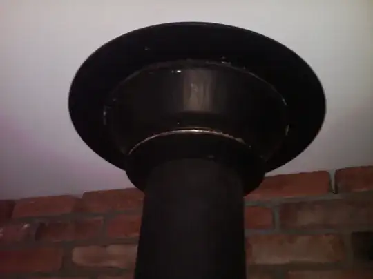

I'm currently renting a house that has a wood stove, and figured that as it's used as a rental property, the stove would be safe to use. However a friend of mine today was telling me that if the chimney is not chrome plated both inside and out that it could be uninsulated and be unsafe to use. The stack outside is chrome plated, the inside looks to just be cast iron, as the attached picture shows.
Can anyone advise if he's right, or if I can safely start firing up the stove ASAP.

Your friend is absolutely wrong. Color doesn't make any difference, and the outside is not chrome, it is stainless steel insulated pipe. Insulated pipe is not required from the stove to the ceiling where it adapts to insulated pipe
