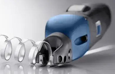

1 - Electric shears and / or nibblers. These are in my opinion, the best tools you can buy. Shears work fine while nibblers are designed more specifically for corrugated or curved panels. If you're a professional, this is what you need to buy.
nibbler to cut metal roof shear to cut metal roof
Fein Nibbler link at Amazon
Trumpf Tools (second picture) also have great shears, but you can't buy directly.
You can buy "similar" tools on Amazon, for a lot less. I don't know how good they would be, but for a one time thing, it may be worth it.
