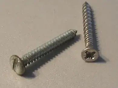

This picture from the Wiki page is just regular sheet metal screws and shouldn't be on a page describing self tapping screws:
Regular screws
These do not have a drill tip, and they do not have a flute to cut threads. Sure they are a little sharp, but not sharp enough to make a hole in sheet metal. They need a properly sized hole. If driven into a hole that is too small, they will tear the hole wider (if they are stronger than the sheet metal) and create a weaker connection than a self-tapper that properly cuts the right threads.

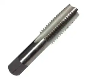

This is what self-tapping means. All wood screws are this, of course. For metal bolts aka "machine screws", it means the very front threads are tapered, fluted to give a cutting edge, and hardened. The hardening happens at the expense of other desirable attributes like tensile strength.
This is a proper tap, dedicated to the tapping task. Next to it is a machine screw that self-taps (but not self-drills).
Needless to say, the self-tapping screw is good for somewhere between 0.3 and 2.0 taps, before it loses its edge. It's not hardened nearly as much as the tap; because it is a compromise between tap cutting and bolt strength.

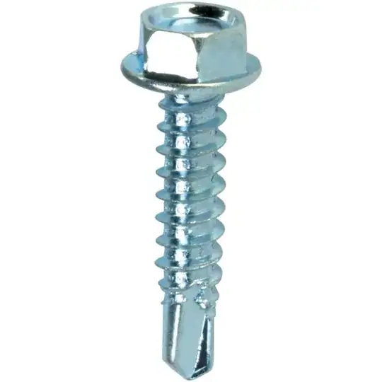

What differentiates a self-drilling screw from a self-tapping screw is that the self-drilling screw will have a sharp drill-bit-like end with no threads at all, much like the top screw in this pic (also from the wiki page):

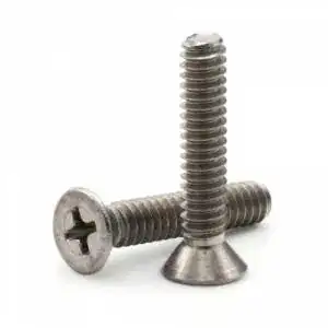

A non-self-tapping screw would be something like a machine screw:

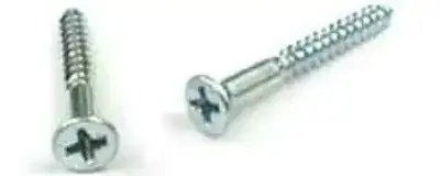

or a wood screw:
In either case, no matter whether the tip is sharp and pointy or flat, there is no flute up the side to enable the threads to cut through the material they're being screwed into.

The easiest way to picture what they do is like this: If you're trying to screw something into metal, you would normally drill a pilot hole with a drill bit, then insert your screw. Tek heads have a built in drill bit at the tip of the screw thereby eliminating (in most cases) the need to drill a pilot hole.
Note: I do not recommend using tek heads when drilling into thick steel or very thin material. Use a drill bit instead.
