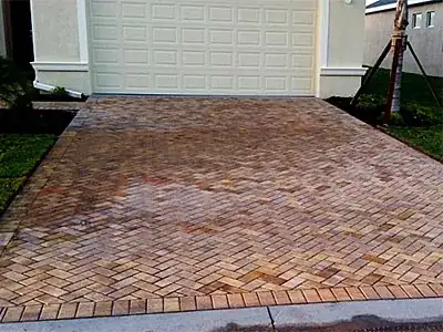

For brick driveways the most important part is a solid compacted base--crushed quarry rock or shale, not crushed river rock. Sand is normally used, not mortar.
For a “green” drive, place the holes vertical and fill with dirt and then grass seed. I have done this and if kept moist with drought resistant grass it works well (but I live in the grass dead capitol of the world). Keeping it trimmed is a chore as a lawn mower is too tall and a weed eater inconsistent. I purchased a Toro fly mow from a friend and that really works well (lawn mower with no wheels floats on a cushion of air). I think they are for golf greens but not sure.
If you don’t want grass turn sideways and use poly sand to fill the cracks. Poly sand really helps prevent grass with pavers. As long as you have a solid base the bricks will hold up. If the base is not solid you will have ruts in short order.

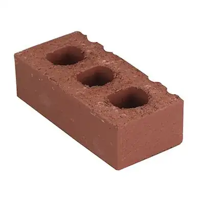

To be clear the OP is talking about something very similar to below - clay cored brick.
Take a good look at this brick - as this is a pretty smooth example. Do you want to walk on that. Note that the corners are usually pretty sharp.
The fact is the brickmakers form these with a rough top and bottom on purpose. That way the mortar binds better and the bricks "lock" into place better.
Notice the core holes too. These are for weeping properties and just to make walls lighter. The edges of these are often sharp too not to mention areas for water to pool and freeze.
And then finally look at the back. The back has grooves in place - you see the 4 notches. All bricks are a bit different but this is normal. So this means there will be more of a gap between the bricks when they are laid out. Giving more chance for freeze heaving and for vegetation to grow.
The reason why is simply - the weeping holes in them provides a weak spot for both water exposure and easier breakage. No matter how you lay these out and flatten them and pour polymeric sand and level it out perfect... Water will still build in the holes. If it freezes it will expand and will crack. Weight from blunt objects will also make it crack easier than its sister, paving brick.
The other thing - who wants to walk on jagged edges? Even with the sand flattened out you will have edges everywhere. Definitely not walking on it with bare feet quickly.
I don't see a reason you would ever use them given the amount of work it takes and you could use another product (that is probably cheaper) that would outperform it and look the same.

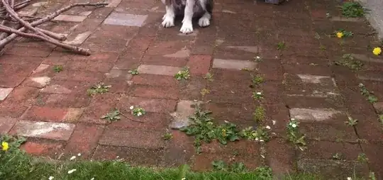

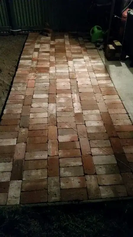

I've done exactly this - had an old retaining wall knocked flat by an earthquake in 2010, and used the red bricks to lay a patio. It worked nicely, but was not particularly resistant to moss and "green stuff" growing.
These bricks date from around 1926.
If you do this, expect to power-wash it twice a year, and that the green can be incredibly slippery in the damp.
To mitigate, I'd suggest cleaning and dunking each brick in silicon sealant completely, and letting it dry/cure before you lay them.
initial laying
after about 3 years, and its due for another power wash.
