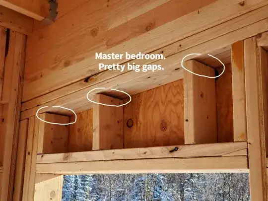

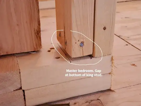

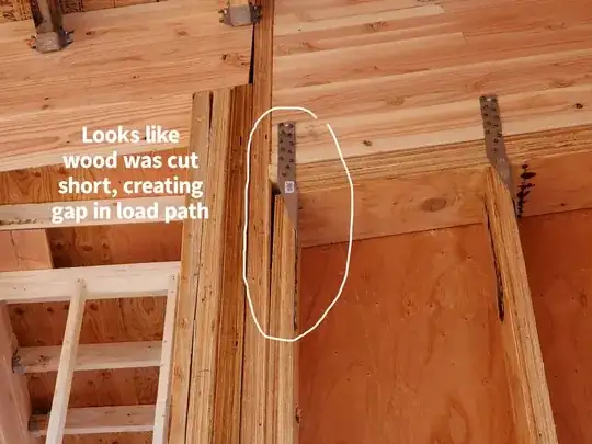

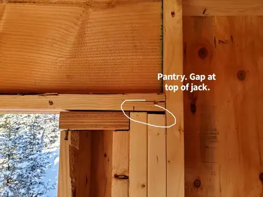

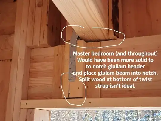

I recently hired a framing crew to frame a new house. After it was done, I commissioned an independent review. The reviewer described some of the work as "shoddy," and pointed out a lot of gaps, particularly between king and jack studs and the plates. I took photos and added his notes to a few studs he pointed out. He also pointed out that the roof beams weren't birdstoothed, as the plans directed, but were instead set onto the headers and strapped to scrap lumber. In one place, the beams are strapped to a split 2x4.
Would it be appropriate to ask the framers to fix some of this work? I don't work in construction, but even as someone outside of the industry I'm looking at this and it just doesn't look good.

  1. In Picture #1 you’ve noted the gap issue, but missed the “double spliced sole plate”. (Splices are to be a minimum of 4’ apart, unless at intersection of a wall.)
  2. In Picture #1 it’s difficult to see, but the subfloor is not nailed properly. (Nailing should be a maximum of 12” apart in the field and 6”” apart at the edges.)
  3. In Picture #2 a twist strap is not an acceptable connector when it’s improperly nailed into a piece of blocking. (The length of the nails need to be long enough to penetrate into the beam...going through the piece of blocking reduces it too much.)
  4. In Picture #2 I don’t understand your comment about the “pocket”, but if the beam requires two trimmers then it needs a connector too. (That whole assembly is questionable.)
  5. In Picture #3 the gaps you circled are acceptable , but I doubt TV he double top plate is nailed together properly. It requires 16d nails at 8” on center (at a minimum) and I see no nails poking through the lower plate. 16d nails are long enough that they’ll show through the lower plate. If it isn’t nailed properly it does not meet code in your area (Alaska) and could fail under any seismic load.
  6. In Picture #4 the framing to too “wonky” to be acceptable, including the gap you indicate at the top of the double jack studs. If the contractor argues that there are other jack studs next to them “so it doesn’t matter”. Let them know that the load is transferred to the foundation at the double jacks...not at random locations.
  7. In Picture #5 the trimmer (jack studs) is not acceptable. It does not provide adequate bearing for that size beam. In addition the 3/4” plywood studs are not acceptable (actually they could produce structural calculations to prove me wrong, but I doubt it would be acceptable in your location for seismic activity.) Also, you’d need to glue the sheathing to the studs and I doubt there’s adequate nailing ...12” on center in field and 6” on center along edges.

Licensed and insured contractor, been building homes for the last decade or so. That beam in the last Pic is sitting on lvl studs, not plywood. They're much stronger than regular 2x material and that strap is kinda hiding the end of the top plate but technically all it needs is 3/4" bearing to be structurally sound. That gap in pantry king stud, while ugly, won't affect anything cause load transfer on trimmer is still solid. To someone responding above, this definitely is 2x6 framing. The master bedroom window picture with the gaps - that top plate is at an angle and they didn't bother to cut that bevel on the cripples, so it's touching on one corner but a big gap on the other. The things I'd be most concerned about have already been mentioned, that bottom plate in the first picture should not be that short... It's literally begging for problems later. Also the beam strapping. That split wood with a couple nails in it that the strap is teco nailed to its absolute garbage and holding nothing. The rest of it, while it looks like garbage and I'd never leave work like that in a house I build, probably won't cause significant issues... Last thing I'd worry about are the problems you didn't see and don't have pictured here. The inspector should definitely catch all these problems and call the framers out on them and make them fix this before anything further can be done. That's how it's supposed to work. Break ground - inspection, lay pipes and such - inspection, build forms for foundation and tie rebar - inspection, pour foundation - inspection, build pony walls (if applicable) - inspection, framing - sheer inspection, finish framing - full framing inspection, insulation - inspection... There should be inspections literally every step of the way to ensure that this kind of garbage doesn't fly. Inspectors are usually cool with problems and will provide a simple way to fix the problems. Hopefully you don't have too many issues getting them to fix the problems.
Any gap under the king stud or anywhere in framing is a result of the framer doing crappy work, because everything in framing has to be on the line and flush and tight. If it's not then the house will shrink and creak, and drywall will crack.

Last picture is beam sitting on plywood studs it looks like need a better picture to see what that beam is attached to and what that beam is supporting
