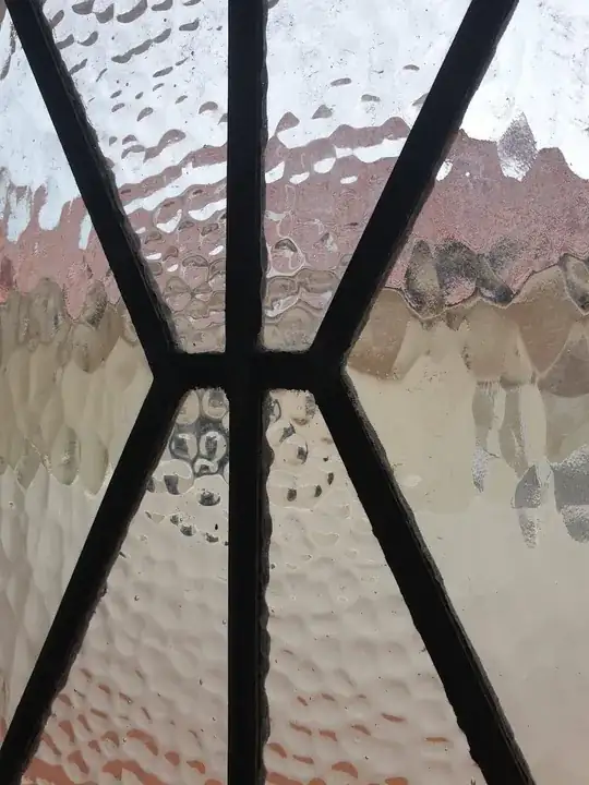

I would like to restore the cames in these windows. I am unsure which metal they are made from. How do I go about this?
This is a picture from the outside which has been exposed to the weather (including salt air): Outside of windows

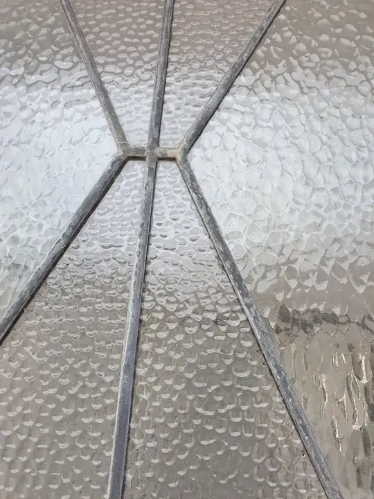

This is a picutre on the inside:
Inside of window
Should this be polished or painted or sanded back?

In my honest opinion, I would not do a thing to them. Sanding will scratch up everything, paint will get on the glass, polishing will ruin the patina, besides the polishing agent will get around places that will be hard to get out, taking away from what you are trying to accomplish. Let alone, all these procedures making it possible to crack the glass

OK, you do not want to sand the cames if a lead solder was used. Since you probably don't know what type of solder was used, let's assume lead. Sanding it would introduce fine particles in the air and since lead it toxic, you don't want to breath it. Clean the cames with a household cleaner. You can scrub it with a toothbrush, just don't scrape it. Then polish the cames with regular car polish. Finally coat the cames with a black patina.
