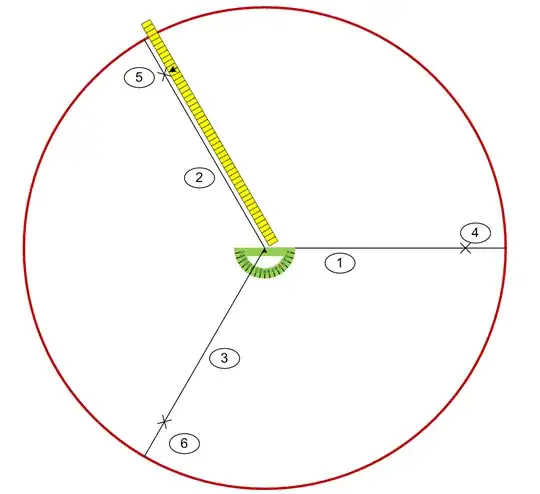

Simply draw a line from the center of the table top to the outside perimeter (1). Then use the protractor to measure off an angle of 120 degrees from each direction from the line you have drawn and make two more lines (2) & (3). These will determine the rotational location for the three table legs. Measure from the center of the table along each line an equal distance to locate the center position of the legs (4), (5) & (6).
