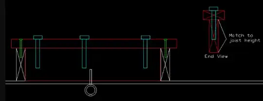

I vote for the solution of providing blocking in the attic but will suggest a technique which is very much easier to install than some of the other answers here. A side on looking picture will get the idea across quickly.
First trip to the attic to access the situation should include making measurements for spacing between the ceiling joists and the vertical height of the joists. Back in your workshop cut the wood pieces to the proper lengths and preassemble the two pieces of wood together using piloted sturdy screws or lag bolts. Also pre-drill the clearance holes in the ends of the upper piece.
As someone else already suggested make a hole in the ceiling where you want the eye bolt from below to be located so you can know where the install the wood assembly.
In the last trip to the attic you can easily install the wood assembly simply by screwing down into the top of the joist. This is much easier than trying to install the blocking by screwing or nailing through the sides of the joists. It also is much gentler on the fasteners that hold up the existing ceiling material.

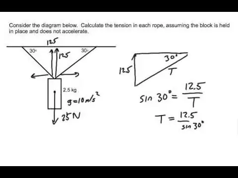

These solutions work but be careful and do the math:
People naively think that if there are two straps then 50% of the weight is held by each strap, but the amount of tension in each strap, and therefore the force on the joists, is both down and inward. If the angles are, say, 45 and 45 degrees at the top and 90 degrees at the connection to the chair, each strap holds 70% of the total weight, not 50%. In the diagram the angles at the top are 30 degrees and each strap holds 100% of the weight.
If the angles at the top get less than 30 degrees then you can quickly get into a situation where the tension in the straps and bolts is more than 100% of the weight applied; it can be arbitrarily high. Remember, tension is not a conserved quantity; you can always make more.
