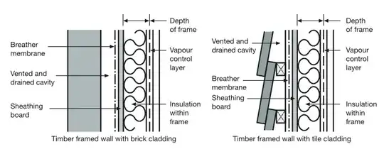

I'm responding to your comment in my answer so I can include a picture.
Most exterior cladding or siding allows air to circulate under it to solve this problem.
If you install plywood in place of siding over the membrane I do think you will still have the moisture issue. You need a space for air circulation.
Second edit
If you attach the membrane to the studs and then cross-batten over the membrane and into the studs and then the plywood/OSB that would give you room for air circulation but structurally I see it causing problems since I don't see the membrane having the structural integrity to properly support the plywood/OSB.
