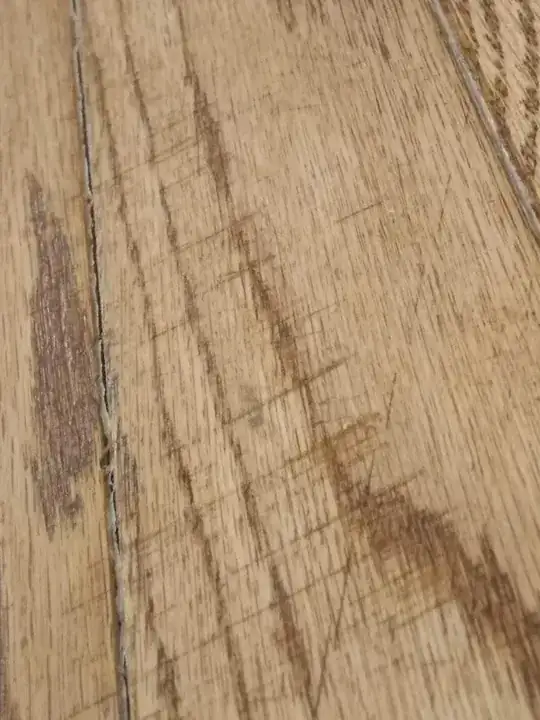

Example 1 (not my own work) - scratches in unstained floor:
I guess this mistake was made by some "pros".

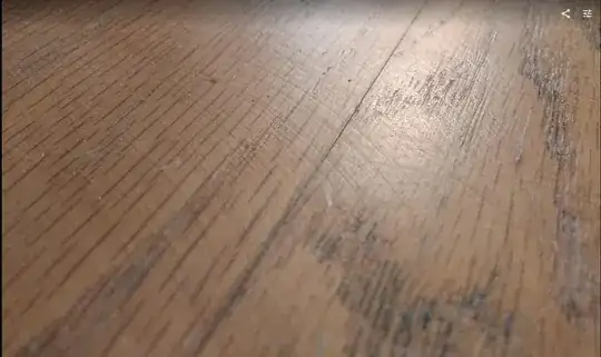

Example 2 (my own error) - scratches in stained floor:
Point being, the first case is pretty hard to see. The second is much more noticeable. To some extent the generally varied oak wood grain does help it to blend in, but not totally.
