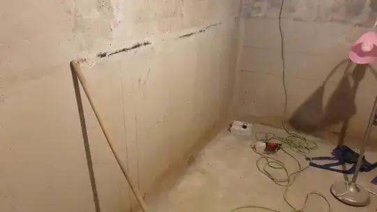

These pictures show the level of stains on the walls. Here you can see what I believe was pretty much the original color of the coating (first pic) vs the back wall. Wall coating, barely stained at all

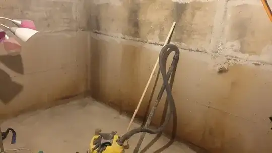

Remarkable dark spots on the coating, probably from oil spray?
Edit / Update: on Friday I primed and then used self-levelling compound (about 750lb / 350kg) to raise and level the floor, which had over 1 ΒΌ / 30mm height difference. The smell is completely gone. So as several of you pointed out, the oil had somehow leaked and penetrated the floor, which is now completely covered by a non porous concrete layer. Thank you all for your kind participation !!!
