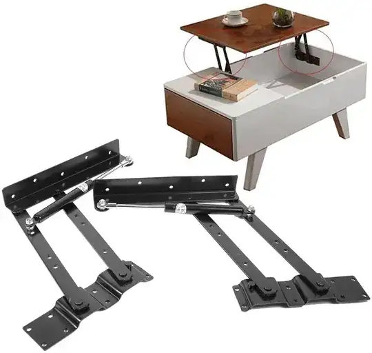

  1. Does anyone know of a product like this one that is larger - preferably with a 2-foot extension, rather than 9inches? My intention would be to use it upside-down, and push the shelf up into the skylight. amazon product link
hinges and coffee table usage
  1. I could probably buy the hydraulic pistons separately, but I don't have access to metal fabrication tools. Do you have any other ideas for how a DIYer could build these kind of hinges themselves with standard tools?
