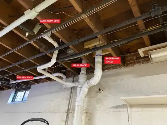

Below is a underneath view of how the plumbing is set up on the first floor:
Basement Plumbing

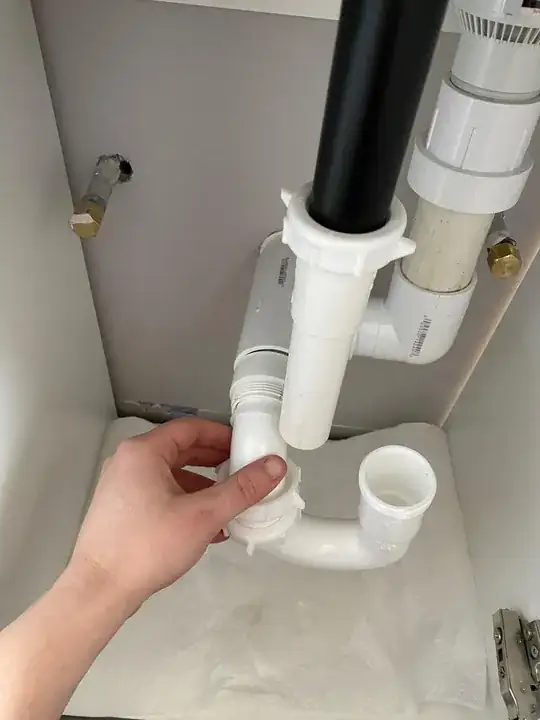

That bathroom sink line is where I am contemplating putting a AAV. Below is a dry-fit of what I am thinking after it comes out of the wall...
Underneath sink
I see that this is a common placement for AAV's, but, it doesn't allow for very much room to hook my P-trap up to my sink drain. I'm wondering if I can put this AAV somewhere else underneath my first floor and if that will be effective. For example, could I put it somewhere between the bathroom sink drain line and my main stack... does it matter where it goes? So long as it is above where the water flows high enough, is that enough?

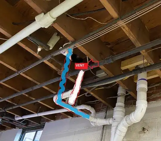

Could I put it like the picture down below? Could I branch off the sewer drain after it goes through the wall and down in the basement like what I've shown? Would that be better? Worse?

You can (in some less strict locales, like rural areas) put an AAV inside a wall or ceiling. The catch is that you will have to have some way to service it, meaning you need an access panel of some sort.
A lot of cities, however, may frown on an AAV that's not readily accessible. Your mileage may vary.
If I were you, I'd simply leave it as you have it dry fit and get creative with some fittings to make it work. It's the path with the least questions (virtually all jurisdictions allow them under-sink).

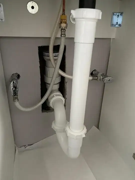

Following up... I ended up cutting out more of the wall and moving the P trap down a bit. There was just no way to fit an AAV underneath the sink without it being an absolute Frankenstein of 45° and 90° fittings.
Instead, I put the vent in the wall above a sanitary tee, which just made for the least obstructed path and easiest to maintain. I will put an air vent cover over the section of wall I cut out for the AAV and patch up the remaining area below around the drain.
Here is a shot of the final:
