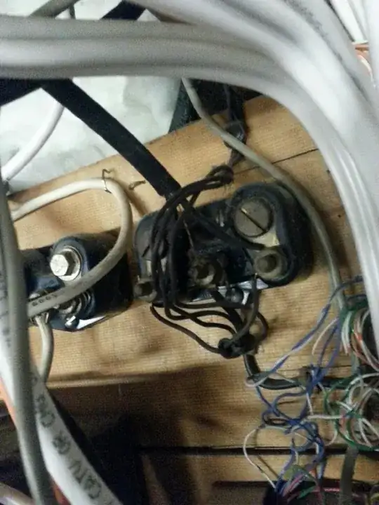

I am going nuts trying to find my doorbell transformer. Someone suggested it may be this. But doesn't look like one to me. Is it? If not any suggestions where it may be?

As indicated by Ecnerwal the picture you show is an old style telephone line hookup. When you go looking around for your doorbell transformer it may look like one of these:

Nope. That's a phone line terminal block. Old school. May have rudimentary surge supression built in. The heavy black wire is drop cable (from the pole to your house)
It's not your doorbell transformer.
