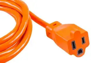

If the power cord on the router is one of the modern type like this ...
Picture Source
... with one blade wider than the other then you have a polarized plug with the neutral routed through that wider prong. You want to make sure to properly orient the plug at the extension cord so that the wider blade goes into the wider slot.
Note that there are lower quality extension cords where it is possible to force in the plug wrong way around because the molded plastic will just stretch. This is one reason that you now see cords that have hard plastic around the holes that is then overmolded with the more flexible material.
