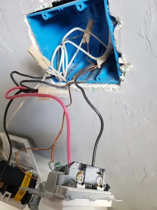

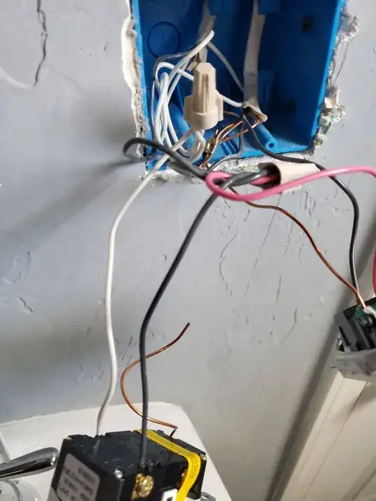

You're pretty close to color-coded here, so I'd get some colored tape and mark stuff up.
The cluster of 4 hots on the wire-nut is all always-hot. It comes from supply, goes onward to some other outlet, and then there are two pigtails going to the 2 switches. I like black for always-hot, but it's not mandatory. I would change that red pigtail out for black, merely for OCD reasons.
The other wire on the existing switch is switched-hot to the existing lamp, and red is preferred for switched-hot, so recolor that wire red.
When you bring your cable down from your new lamp, also mark that hot wire red, since you want it switched also.
Now, you just join up all like colors. Note that you can't put 2 wires on that kind of switch, so you'll need to pigtail that also, with another wire nut. And look! You just freed up a red pigtail, how convenient!
Also, that switch uses backstab connections. Firmly pull while twisting those wires out of the backstabs, then never use backstabs. Shaping a J-hook and using the screw terminals is harder, but 10 times more reliable if you take the time to learn it. Backstabs are notorious for failing "open" and creating puzzling wiring problems that are very hard for novices to troubleshoot. Those problems get posted here every day.
Lastly, you can get a "double switch" that fits in the single gang, which would allow you to switch the two lights independently. Then you put always-hot/black on the common (typically black) and then a switched-hot/red on each of the screws on the other side (typically brass colored).

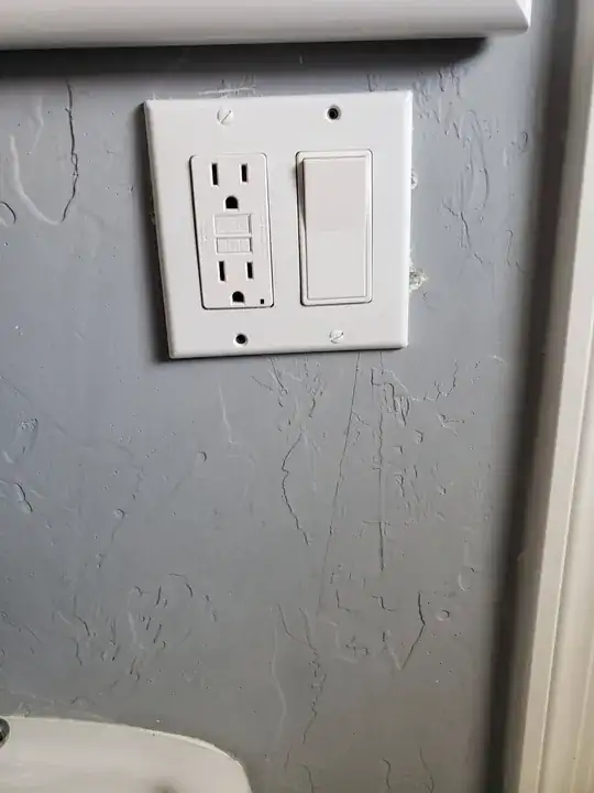

P.S. Note how the warning tape has been left alone on the GFCI receptacle. That is correct. That is how every GFCI install should look (except when the installer actively intends to extend GFCI protection to additional points on the circuit).

You're going to run a new 14/2 (plus ground) cable* down from the light and connect it to the same points as your current light's cable:
  • The white wire goes to the bundle of whites
  • The black wire goes to the screw on the switch that has the black wire now
  • The bare ground connects to the ground bundle
It looks like that switch can accept multiple wires under its clamp. If that's the case, you're golden. If not, remove the black wire and bundle it, the new black wire, and a 6" pigtail in a nut, then connect the pigtail to the switch.
Good luck. If you haven't already done some reading on basic house wiring, please do. There's a right and a wrong way to do even simple things, and your safety is at risk.
*It looks like you have #14 wire now, even though modern code calls for #12 wire on a 20A circuit. If I'm wrong, match what's there.
