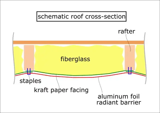

Question: Is it allowed to staple an aluminium foil radiant barrier (assume fire rating Class A / Class 1, ASTM E-84) over the paper facing to meet code as shown in the figure below? It's easier to install compared to drywall.
Schematic Garage roof cross-section
